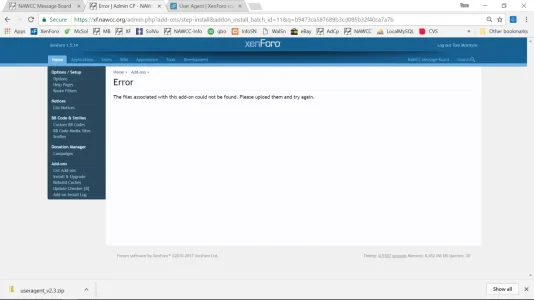

I thought perhaps there was a problem with my computer, so I downloaded another add-on zip file and installed it without any problem.
When I did that with this add-on, I got this screen response.1503926669063.webp
I did not try to manually install since I was trying to understand this issue. It is a new install, not an upgrade.
I interpret the result as a problem with the zip file for this add-on. If it cannot be fixed, I can always do it manually.

Has anyone installed this on 1.5 in the last week. The zip file I have causes addons and upgrades to report missing files.
Apart from trying 4 installs, I have not had time to investigate this further. The error report shown above does not say what is missing.
We have zero issues. Our zip pack had 21 Files and 15 folders and we upgraded from 1.2.2 to 1.2.3 - no issues.
I also tried it on a raw test board that didn't have it installed previously, no issues.
My best guess with your issue is either how you are uploading files to your webserver or possibly the client settings to do the upload.
(Standard Proc.: Upload contents of the 'Upload' folder to your server, which in this case is just a 'library' folder. This should be merged right into in the existing library folder under your site root. If it's an upgrade, you should be overwriting files. Otherwise, they should fall right into place. Run the .XML file included, found above the Upload folder, in the zip root.)
Also, all of our sites are 1.5.12 or newer. Biggest site is 1.15.13, but the test version is 1.15.14 and no issues reported.
