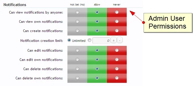

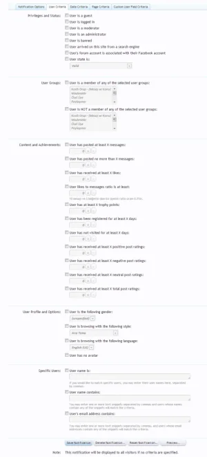

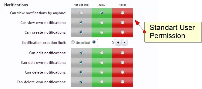

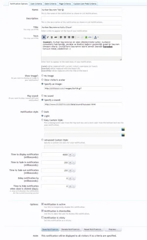

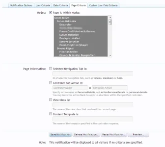

I finally got around to test the addon. I've set the permissions, created a notification without usergroup specifiation, selected it to appear in all forums (selected the whole list) but the notice doesn't appear :S Tried debugging by shutting down addons one by one but couldn't get too far.
I'd need to know the exact criteria you've chosen.

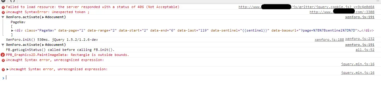

Also, check F12 in your browser in case any errors are logged in the console

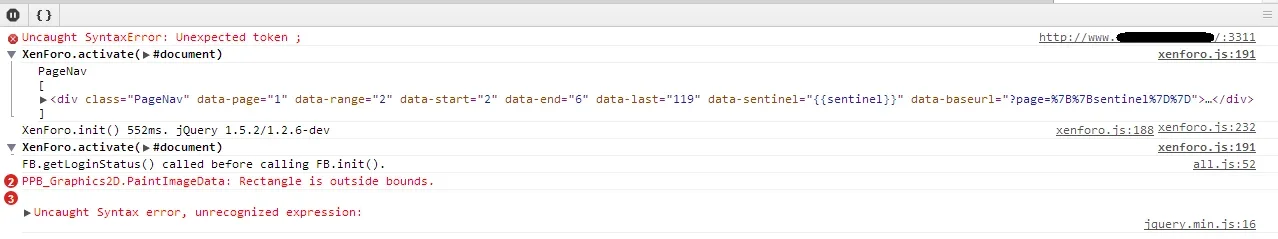

The first error in that error log is the problem. The javascript can't load... I've never seen 406 not Acceptable before...
It seems like you have some other javascript errors... It looks like you may have bigger problems than just my add-on... Is there any other functionality on your site that isn't working?

+ With all the addons uninstalled the error console looks like this:

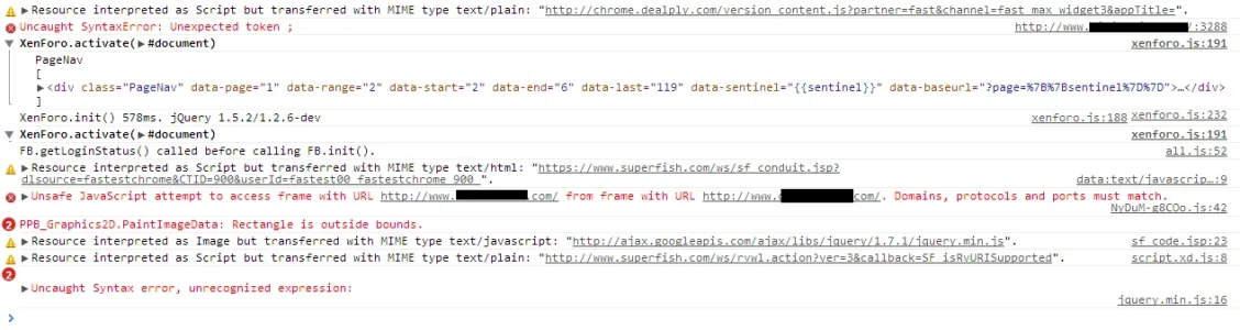

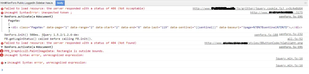

This is another one (with js folder being reuploaded and addons active)
The "status of 406 (Not Acceptable)" I am reading can be caused by mod_security.
Would be interesting to see if the problems are resolved if mod_security is disabled.
To give a little bit more detail, in case you need to discuss with your hosts/server person or for your own benefit...
The specific item that isn't loading is jquery.cookie.js.
This is a very small, simple jQuery plugin for setting cookies and reading cookies. This is used so when someone dismisses a notice, it is dismissed for X hours. I will be removing this dependency in the near future.

I have disabled mod_sec. The error disappeared but the notification still is not showing up.
Uncaught SyntaxError: Unexpected token ;
Could be a pretty big problem.
You've previously been censoring your site URL. You haven't in this screenshot, but it enabled me to look at what code was causing that error.
That error is caused by this line of code in a template:
<script>$(".twitter-tweet").children("p").css("border-bottom", "3px double rgb(208, 208, 208)"), ;</script>
I'm pretty sure the erroneous character on that line is the comma I've highlighted in red.
Is this an add-on? A template edit?
