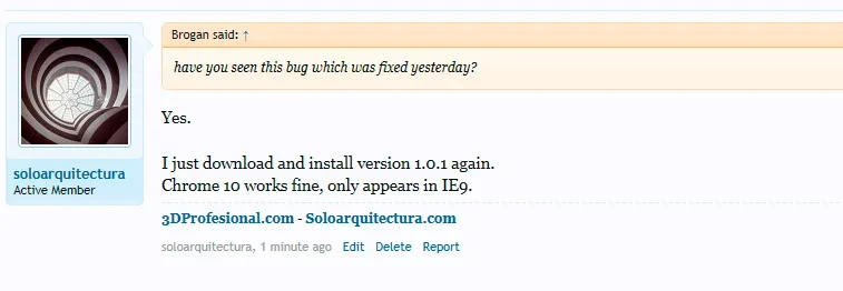

I think there are still quite a few issues with IE9 compatibility mode on or off.
Xenforo eating line feeds is one of them. Needs to get checked.

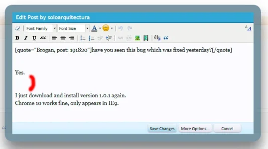

I can confirm the issue and it's in our HTML to BB code conversion. As such, it's actually really really evil to fix.

At times I will make a post, it will appear perfectly, then I will edit the post and save, and I will notice that the line spaces changed elsewhere in the post, in an area I did not touch. This has happened on multiple occasions. If you do go digging in that dark evil place, you may notice something related to this issue.
