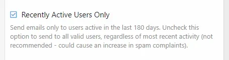

Is there a possibility to lift this restriction? I need the option to send this weekly digest regularly to all users, no matter when they last showed up in the forum.
I use this as a tool to get "sleepers" back. That restriction makes it impossible to contact these sleepers.
@snoopy5 - FYI v4.1.0 now allows admins to choose to bypass the recently active users limitation and send to all valid users instead:
