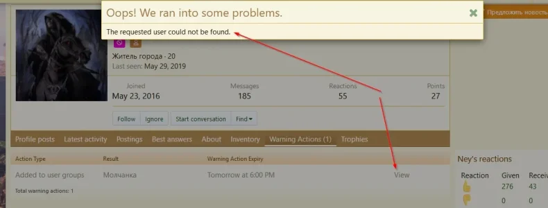

1. When you disable the "View own warnings" option, it gives an error when viewing someone else's profile with the "View Warning Actions" option enabled in the "User group permissions" settings:
Oops! We ran into some problems.
The requested user could not be found.
I’m sure this option check is superfluous in the canViewWarningActions function of the \src\addons\SV\WarningImprovements\XF\Entity\User.php file. Without which everything works correctly:

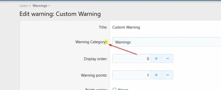

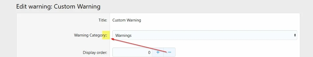

Fix duplicate : in phrase when issuing a warning with radio selectors
They stayed:
It is generally necessary to remove the colon from the code of the sv_warning_action_edit template:
<xf:selectrow name="sv_warning_category_id" value="{$warning.sv_warning_category_id}" label="{{ phrase('sv_warning_category:') }}">
Fix like this:
<xf:selectrow name="sv_warning_category_id" value="{$warning.sv_warning_category_id}" label="{{ phrase('sv_warning_category') }}">
And in other templates also remove the colon ;)

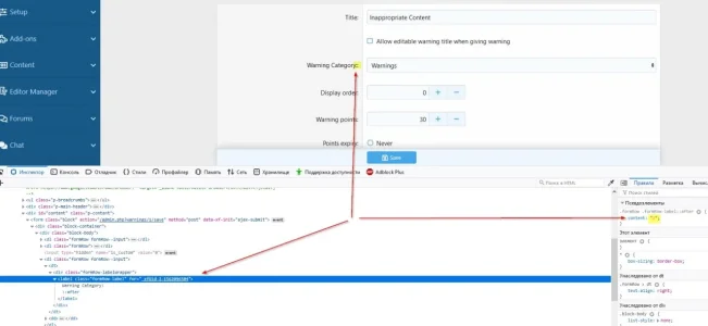

It is duplicated, because in addition styles colon is put:

There is a radio-box selector and select-box selector options; only one was fixed last release.
Should be fixed for the next release
PHP:
        if ($visitor->user_id == $this->user_id)
            return \XF::options()->sv_view_own_warnings;

This isn't the correct fix. The issue is the warning action list and individual warning actions are not checking against the same user.

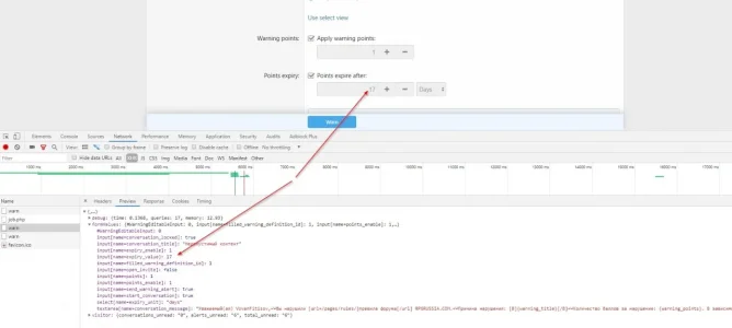

I'm not able to reproduce this. please check the console (network tab) to see what values are being sent to the browser as I suspect there may be some client-side scripting breaking things
Everything is normal there, there are no errors.
You need to verify what the expiry values are in the json retrieved when the browser hits the warning end-point to get warning details via ?fill=1
Try this with all other add-ons disabled, as this add-on updates the expiry value before it is sent to the browser.
I apologize, I did not understand this phrase, how exactly should I use it?
If possible, set an example.
Language barrier burdens communication🤷‍♂️
If I understand correctly, then you ask about it:
Correct, those are the values you need to confirm are being changed as expected.

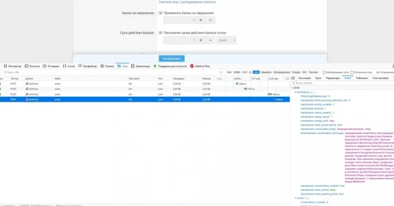

$input variable is empty:
Screenshot with the parameter ?fill=1 and disabled additions. Everything is OK there:
I'll check later what you write :)
The $input variable should never be empty as getWarnSubmitInput returns a non-empty array.
Sorry, wrong translation. Carefully look at the entire video (which I recorded last), how variables are defined in the $input array, and as a result it turns out over time.
I think for the data in the array $input you need to do an additional check, with filling in the correct data.
