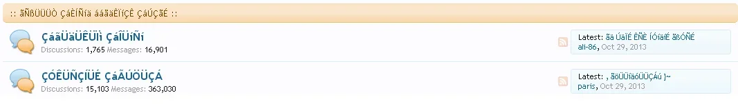

Hi all,
I have imported an Arabic VB3 forum, but the Arabic text in the final Xenforo forum is not encoded properly as shown in the attachment.
Would appreciate any input from anybody to help my figure out how to fix this issue.

Hi all,
Thank you in advance.
You'll have to do a search and replace to fix the broken chacaters in MySQL.
Thanks for your response, Slavik.
The issue is not only with few broken characters, it is the whole alphabet. Is the search/replace solution recommended in this case as well?
This setting can be used for changing the character encoding:
	// USE THIS SETTING TO SPECIFY AN EXTRA PIPE FOR ALL OUTPUT RECORDS
	// EXAMPLE IS TO PIPE OUTPUT THROUGH iconv IF CHARACTER ENCODING CHANGES ARE NEEDED
	// '| iconv -f LATIN1 -t UTF8'
	public static $extraOutCommand = '| iconv -f LATIN1 -t UTF8';
It is at the top of the Export script.

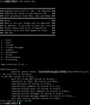

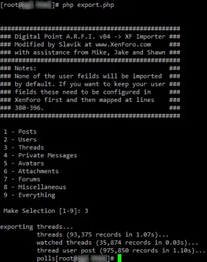

Hello everyone,
We've just started some test runs with the export/import procedure for migrating to XenForo from vBulletin 4, but unfortunately we can't seem to be able to export the user data.
This is everything we get from the command line, no errors, no anything. The xf_user.txt and xf_user_authenticate.txt files are both created, but are 0 bytes each (no content). And yes, we made sure that there were no commas in the usernames that we were trying to export.
Any ideas on what might be causing this or how we can activate an error log of sorts to see what's wrong?
F1?

Any error in the xf error log?
None. The more annoying part is that the export for Posts for instance seems to work fine, but the one for Threads runs into the same issue as the Users when it has to process the Polls (pics attached). No errors, no anything, just returns to bash.
