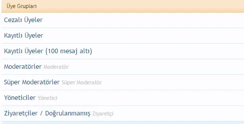

  • First of all, here are all the user gropus we have:
  • Those are from top to bottom:
    • Users with Warnings
    • Registered Users
    • Registered Users with less than 100 posts
    • Mods
    • Super Mods
    • Admins
    • Visitors / Unverified Users

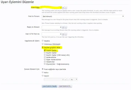

How does our system work?

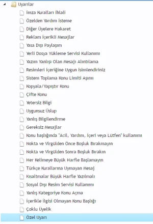

We have penalties for different behaviours. Here they are: (Uyarılar means Warnings)

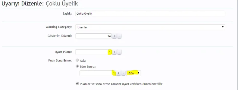

For example, Multiple Accounts:
User get 1 Point for this. And 1 point is 1 day becoming a part of "Users with Warning" Group.

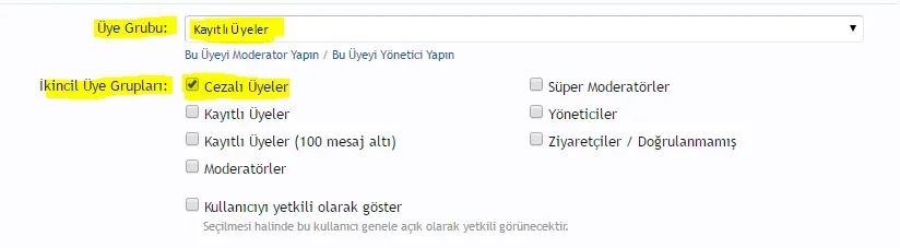

And this is the system that adds user to that group. If they have 1 point, they are also added to Warned User Group where their rights are restricted.
After a day, they are removed from the Warning Gropup and they are just plain in the Registered User Goup. But that does not always work as intended. It gets stuck.

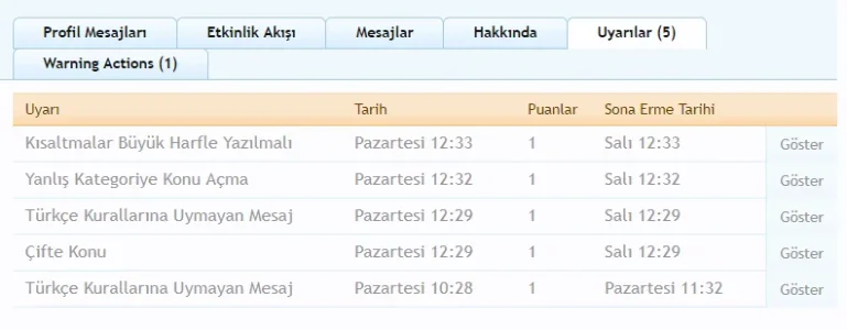

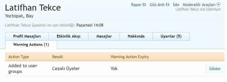

Her is a user with warning:
Main Group: Registred Users
Secondary: Warned User Group.

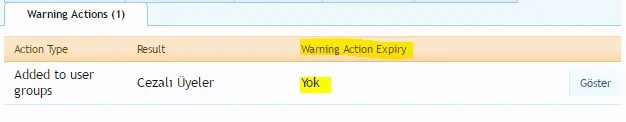

We alse have Warning Improvements 1.4.7 intalled. But interestingly, it shows that warnings do not expire:
Yok means no. But there is actually an expiration date which is 1 day. And users are removed from warned state after 24 hours. Most of the time.

@Recep Baltaş you have the warning configured to expire when "While at or above points threshold" rather than time-based, this is triggered off the warning point totals stored on the account and not the actual total of non-expired warning points from warnings.
Can you verify that an affected account's warning point total matches the warning points for non-expired warnings?

Just needs one warning that issues 1 point then an action that sets a temp user group and applies when points are at or above 1 point.
Apply two warnings and the action will kick in. When the cron expires both of those - presumably at the same time - they are both expired but the effect of the action still applies.
