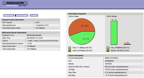

Here's my memcached stats...as you can see, there's plenty of memory available:

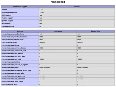

I have also attached my phpinfo page below.
