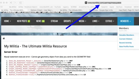

You are using the wrong URL for mass update. That's why it's not working. use yourdomain.com/usermap/massupdate not usermap?massupdate and this should now work, now that you have the google API figured out
I TRIED IT , ONLY ERRORS

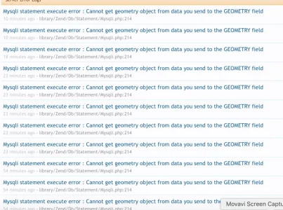

The Geometry field seems to tell me that it's trying to get something that's not there. That's why I suggested unchecking the IP fallback (thinking that something is buggy with that possibly too)

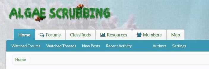

Please remove the map Nav tab from the "Forums" navigation and move it to the "Members" tab. Change the link just to "/usermap" because that is what users expect in common sense.
I would agree, this makes a lot more sense
But it already is this, isn't it? what am I missing...
No, the (only) nav tab link is "https://www.yourwebsite.com/usermap?viewuser=1/" at least on my website. And I see no other nav tab beside "View Your Map". What would a user expect? He would expect to open the general user map in general.

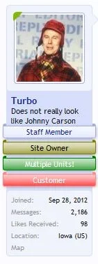

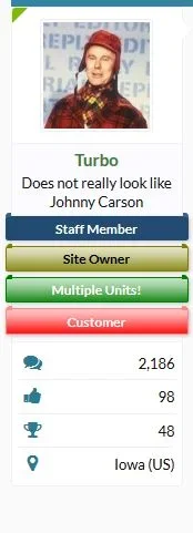

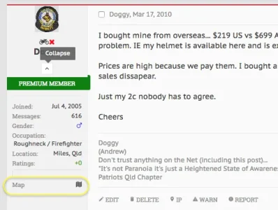

Are you referring to the Show link on user info box checkbox in the ACP Option? I too am curious as to what this is referring to (meaning where are end-users supposed to see this?
Message User Info ....
... icon on the right is clickable and takes you to the usermap, centered and zoomed on the user.
