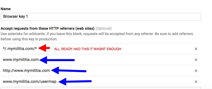

thats my 16th try at this not even using them anymore@DieselMinded you don't want to post that key publicly. You will need to regenerate it and update it.
also that just means you have set up the key. You need to go through this part

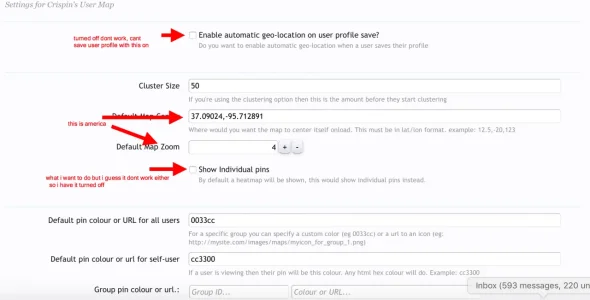

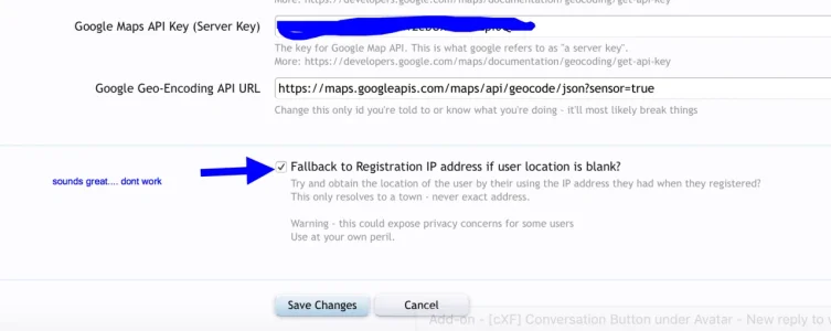

Uncheck Show Individual Pins on ACP Options page?still cannot do mass update as page just refreshes and does nothing
i fixed itDude. */.mymilitary.com/* is not the correct syntax. Calm down. you needed to have this as *.mymilitary.com/*, the extra / was causing this whole issue
They would only be able to do it if they knew the link. Do it once, uncheck the box on the ACP options page, and then no one will be able to do it. You shouldn't need to do it more than once I don't think either though.i do not want my members to be able to perform the mass update , you need to add a button to the admin cp to do this
Tried it again don't seem to matter either wayUncheck Show Individual Pins on ACP Options page?

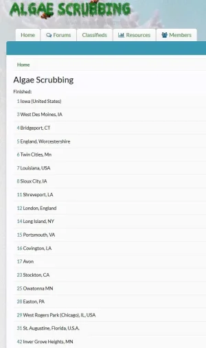

When you run Massupdate, does it just take a few seconds and then refresh the screen, or does it take a minute or two and then show you a screen like this:

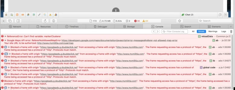

Any server errors?

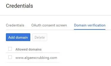

On your API console, open to the page on the Geocoding API Useage screen. Do you see a whole bunch of requests?
