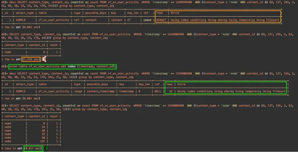

cyberdyne
Hello,
i have huge forum with >3-5k online users at peak.
forum node list counters are slow. main page generates 7-9 secs.
after analysis i found a problem query and built an index.
You can add this to the next update.
result here:
195434

Xon
Hello,
result here:
Thanks, I'ld recommend using redis normally for that should that should help for the next release.
