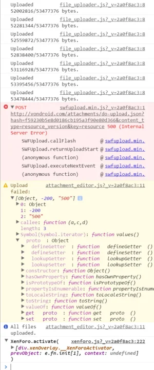

I upgraded from 1.3.1 to 1.5, and since then uploads complete (as shown in console) but then fail with the "There was a problem uploading your file."
I've tested 1MB, 50MB, 250MB, and 500MB files (server limit and XenForo limit is 2GB). There have been no php configuration changes.
I've attached a screenshot to show the console output.
Could you try it again with the Flash uploader disabled? Sometimes this can mask a more detailed error message.
It appears to have been a minor hiccup - I've tested a 50MB file and it's now working (Flash uploader). I'm just testing a 500MB file to see how large items are handled, and if that fails I'll try your suggestion and report back.
