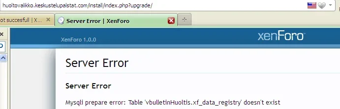

Hey guys, this is what I get after trying to update to 1.1 from 1.0.4, error shows after step2.
I have 2 Xenforo sites, the other site upgraded to 1.1 ok though.
Any ideas what to do next?
Server Error
Mysqli prepare error: Table 'vbulletinHuoltis.xf_identity_service' doesn't exist
  1. Zend_Db_Statement_Mysqli->_prepare() in /home/xxx/library/Zend/Db/Statement.php at line 115
  2. Zend_Db_Statement->__construct() in /home/xxx/library/Zend/Db/Adapter/Mysqli.php at line 381
  3. Zend_Db_Adapter_Mysqli->prepare() in /home/xxx/library/Zend/Db/Adapter/Abstract.php at line 478
  4. Zend_Db_Adapter_Abstract->query() in /home/xxx/library/Zend/Db/Adapter/Abstract.php at line 734
  5. Zend_Db_Adapter_Abstract->fetchAll() in /home/xxx/library/XenForo/Install/Upgrade/1010031-100b1.php at line 374
  6. XenForo_Install_Upgrade_1010031->step3() in /home/xxx/library/XenForo/Install/Controller/Upgrade.php at line 115
  7. XenForo_Install_Controller_Upgrade->actionRun() in /home/xxx/library/XenForo/FrontController.php at line 310
  8. XenForo_FrontController->dispatch() in /home/xxx/library/XenForo/FrontController.php at line 132
  9. XenForo_FrontController->run() in /home/xxx/install/index.php at line 17

No go, seems i am stuck, the error in my 1st post now repeats itself after restoring the 16hr old database.
Cant even get to the start of the upgrade, the error pops up right away now.

No go.
I restored a few days old website files.
Imported a 18hr old database.
Same error as in 1 st post shows up in /install.

Its really strange, i have now tried restoring older databases too and looks like they are always missing that table.
