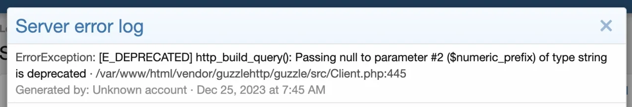

Guzzle 6.x doesn't support PHP8.x. Are there plans to upgrade Guzzle to start using Guzzle 7? I have tried to use my own version of Guzzle with a different composer install, but ran into conflicts if there were CLI scripts attempting to use the later version of Guzzle.
If there are no plans, has anyone been able to successfully use a later version of Guzzle? Thanks.
Guzzle 6 works fine with PHP 8.x. What difficulty are you experiencing specifically?
@Chris D , thank you for the fast response! But this is the issue I am running into with Guzzle 6. I know the include path is our custom composer folder, but the version that is in the vendor folder for XF matches what we have in our own folder.
Here is a link to an issue that someone reported to the Guzzle team and their suggestion is to upgrade to v7... :confused:
This is just a deprecation notice. We handle these specially in XF. These are only logged with debug/development mode enabled and are silenced otherwise. These don’t interrupt execution or affect users in any way.

Forgot to mention earlier but XF 2.3 ships with Guzzle 7.5. In the meantime, for the reasons I mentioned, the deprecation notice is safe to ignore.
For jobs that are run through a CLI command, it is breaking out of jobs and not completing them. Possibly due to my PHP setup, so I'll keep doing some digging.
