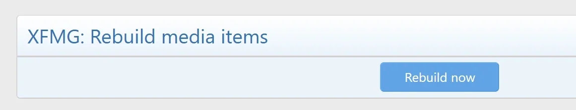

1) Rebuild media items cache (and every cache to do with the media gallery)
2) Rebuild Media Gallery add-on

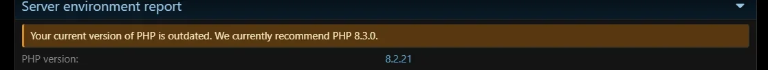

I don't think so, 8.3 is the recommended version...

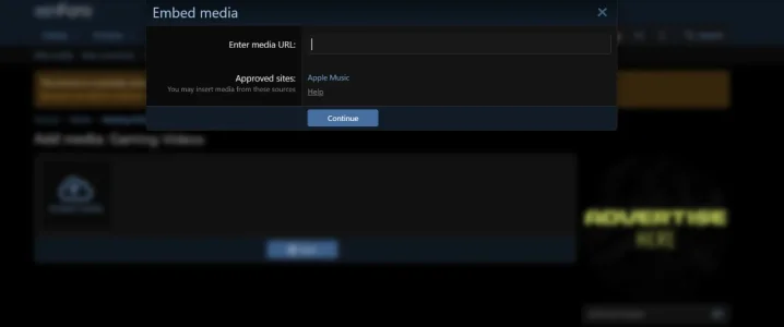

I noticed the only "Approved sites" after the upgrade is Apple Music, so Youtube and other sites are now not listed there, how do I fix this, if I even can?
I just noticed the only embed 'approved sites' is apple music, as you can see here:
Which I believe is why my other things are now broken. How do I fix this? Can I even fix this? please advise.....I haven't changed any settings prior to upgrading so I'm not sure what changed unless something within the 2.3.2 version of XFMG changed itself?
Looking to embed Youtube, Twitch vods and Tiktok.....please advise.
XF is recommending it, yes:
Yeah i'm on 8.3....

Did you try to rebuild XFMG??
Yes I did. Re-uploaded the files and rebuilt the add-on, still the same result :(.
