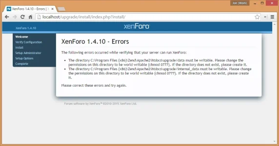

If the upgrade package is used for a fresh installation, then you will get an error like:
If you follow these instructions, you then get asked to create a new installation.
