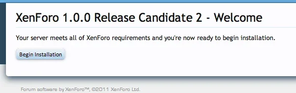

Just uploaded the upgrade package to the server, opened it, and dragged the new files to the old ones. This is not how I usually do it, but I thought it would have been quicker than uploading the individual files. When I go to the forums it wants to start a fresh install. What did I do wrong?

Hm I can't upgrade, even with the config file edited with the old info it keeps redirecting to a fresh installation?
dutchbb
The installer asked me to remove that file if I wanted to re-install, so I removed it, but then it redirected to a fresh install instead of an upgrade.
dutchbb
Is there some kind of option I need to change to make it upgrade instead of install?

Provided you're going to <url>/install/, then one of those files must not exist - I suspect it's internal_data/install-lock.php.
dutchbb
Yes I removed install-lock.php because it said something like 'already installed, remove install_lock.php to re-install'. I thought that way I could upgrade. Oh well I have a backup so I'll just put it back and try again :)

That is wrong. You can't upgrade unless the internal_data/install-lock.php file exists.
You can replace the file to fix this. Just create a new file called install-lock.php inside of the internal_data directory. It only checks for the existence of the file. The file doesn't need to contain anything.
Once the internal_data/install-lock.php file is in place then load the /install URL again. It should direct you to the upgrade system.

I removed it because when it was there I could not upgrade either and the installer told me to remove it if I wanted to re-install. Anyway, I just re-uploaded everything and created the install-lock.php file again and now the upgrade worked.
Thanks for the help.
