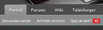

Hum
The counter only appears on my Portal index :

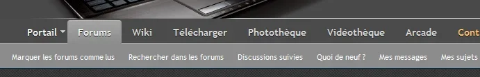

But not on my forum Index :
Any way to fix that ?
