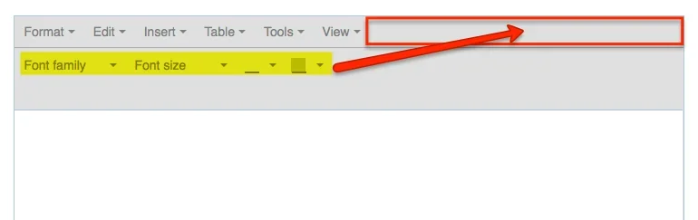

Also, is there any way to move the bottom drop down list (font family, font size, etc.) inline with the top drop down list? (see screenshot)
  • For the icons, check if your browser doesn't spoof its user agent. If you're using a cache be sure to update it with the font icons (I will not provide support for this).
  • To configure the buttons, install the Bbm.
  • To configure the editor display (with or without menu), please go inside this addon options. Everything is explained there. If you selected to force the display of an icon (menu mode), just unselect this icon and it will be integrated inside the menu.

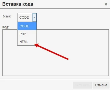

How to add code from GeSHi Syntax Highlighter https://xenforo.com/community/resources/geshi-syntax-highlighter.89/ in code menu TinyMCE Quattro?
I add in editor_dialog_code <option value="python">Python</option>
HTML:
    <dd><select name="redactor_code_type" id="redactor_code_type" class="textCtrl">
        <option value="php">PHP</option>
        <option value="html">HTML</option>
    </select></dd>
In standart redactor xenforo all work good!
But no effect in TinyMCE Quattro :(
