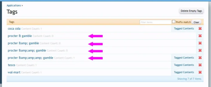

when I create a Tag containing the sign "&" like for example "Procter & Gamble", then there is an issue.
I have created a Tag named "Procter & Gamble".

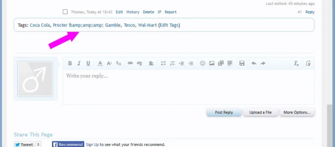

Then the system creates 4 different Tags and it also changes the wording of the thread-text from "Procter & Gamble" towards "Procter amp amp Gamble".
See screnshot below.
This seems to be a bug.

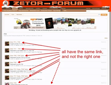

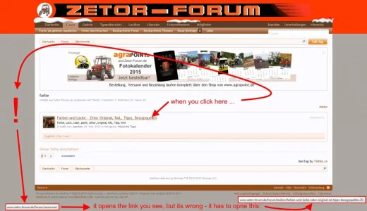

When I tag a post - all just fine. But when i tag a resource (RM 1..1.5, xf 1.4.3) i become a problem with the link to the resources when every body clicks on a tag, it opens this view:
... and as you can see - the link to the resource its wrong. And this is since after version 2.1 same with all resource links. Only the post tags work correctly.
Has any body a hint how i can fix this - thats realy bad for my site. :confused:
Edit:
Additional Informations:

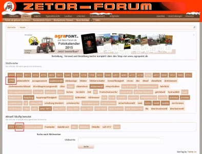

The tag-cloud: http://www.zetor-forum.de/forum/tags/
... click here on any number tag, "7745" eg (its the type number of a CZ tractor) and a new site will open:
http://www.zetor-forum.de/forum/tags/?t=7745
... but all found tag entrys will have the same link to the resource manager root:
http://www.zetor-forum.de/forum/resources/
... here you can see for this tag listing listing above, the right resources and there real links:
http://www.zetor-forum.de/forum/literatur/categories/zetor-7711-7745-turbo.24/

Is this Add-on supported? Many peopel post many problems since v 2.1 and the Add-on coder? No answer - realy? :/ I have send a conversation to the author - and he say, he ist looking. But also nothing... (n)

1)

AT this time Xentag don't support & character in name. Because tag name will be used on url, it will be encode to html entities.
https://xenforo.com/community/threads/tinhte-xentag.32231/page-67#post-882063
I have made test with deactivated add-ons and i found the "bad combination"
The latest version from Waindigos great Resource Managers Add-on made in Jul, 2014 (1.0.9) in combination with this also great Add-on (Tinhte XenTag) in version 2.1.3 and above make the link trouble.
Waindigo Resource Managers 1.0.9 + Tinhte XenTag 2.1 = OK
Waindigo Resource Managers 1.0.9 + Tinhte XenTag 2.1.3 or 2.1.3.c = trouble with tag links to resources
So i hope now Tinhte or both coders can found a solutionn to use both Add-ons at same xenforo, at same time. ;)
