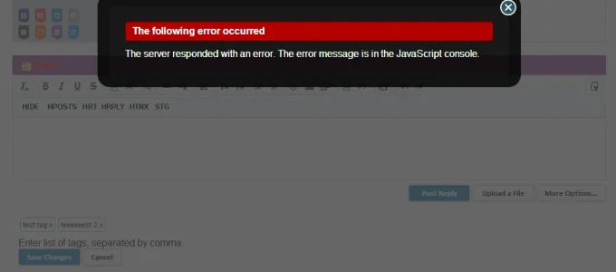

Hello @Dinh Thanh
I using XenTag and work good with XenForo 1.1.x
but ... with XenForo 1.2.x is XenTag not work good
I create XenTag in New Thread and edit Tag in Thread View... but XenTag error
I found the error line
PHP <br />
<b>Fatal error</b>: Call to undefined method PHCannouncements_DataWriter_Thread::Tinhte_XenTag_setTags() in <b>/home/user/public_html/domain.com/xen/library/Tinhte/XenTag/XenForo/ControllerPublic/Thread.php</b> on line <b>83</b><br />
xenforo.js?_v=26a36c99:209
c.extend.handleServerError
I think addon error with XenTag is PHP Help Center Announcements
http://xenforo.com/community/resources/php-help-center-announcements.2067/
In the code of that add-on
PHP:
<?php
class PHCannouncements_DataWriter_Thread extends XenForo_DataWriter_Discussion_Thread
    protected function _getFields()
        $fields = parent::_getFields();
        $fields['xf_thread']['sticky'] = array('type' => self::TYPE_UINT, 'default' => 0);
        return $fields;
The author implemented it the wrong way and caused fatal error with this add-on. That add-on will cause serious conflicts with other add-ons too. There is nothing we can do for you here, you have to disable/uninstall the other add-on or ask the author to fix it. I will come to the thread and post my finding too.
@xfrocks Thanks you.. I uninstall addon Announcements and XenTag work with XenForo 1.2 Good
I hope author Announcements update it and bug fix the next time
