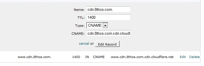

This
Changed to this sometime after I hit the orange cloudflare button.
Now attachments are broke again.
In Advanced Zone Editor.Both are wrong.
In cloudflare: Add a cname: cdn -> 8thos.com
In your hosting control panel, you only need to add a pointed domain (cdn.8thos.com) to your hosting account.
Noone config DNS at 2 places.
That's all.
