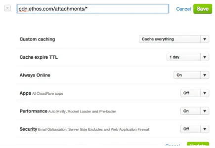

In case of using CloudFlare, if you have Pro Account, please add A Rule for your domain like this to let CloudFlare cache all attachments file (normally CloudFlare don't cache file without extension like .css .js, .jpg, .png, .gif,...)
