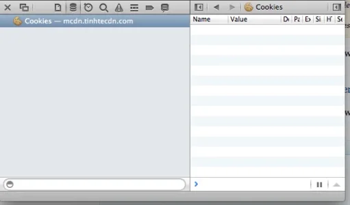

Just make a test account on MaxCDN.com. Set it up then working without any issue.
There is no issue with my addon. I think Adam have issue with .htaccess or something.
MaxCDN setup is standard. Nothing was changed.

So it's not your addon, just our htaccess? What's yours look like?
Adam post yours please.
This is mine.

I'm using Xenforo standard .htaccess.
Could you give me a thread url with image attachment? Then can you send me your CDN Config (domain & original)?
