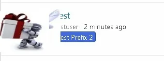

Well, I tried using that verison, but no difference. Everything is fine until I try to make the thumbnail larger. Here's what an avatar looks like in the XF style, using exactly the example code they give, except I've changed the width to 100px and the height to 75px:Oops I'm on 2.6.0. I wonder if they changed something!
First off, see how large the avatar is. Second, note that what you're mostly seeing there is the "mini" avatar superimposed over the main avatar after replying to the thread. Anyway, time to watch a movie or do something that's actually pleasurable, ha ha.
The problem has nothing to do with any style I'm using. It's obviously the css itself. I've tested all this on a completely new local XF install, using just the default style with all default settings and no other addon's. The code in your FAQ that you initially referred me to as an example just doesn't work, so you might want to think about providing a better example. Copied and pasted exactly as is, it results in this:As you are using a custom theme, the CSS rule provided here might not work or might work incorrectly for you. Please share a publically accessible URL with us, and specify how you want the avatars and thumbnails to look, and we will have a look.

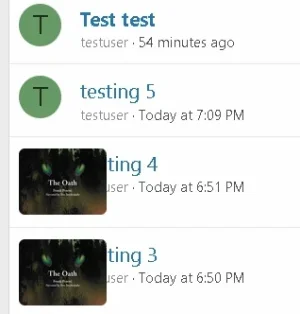

OMG, I think I finally figured it out <fingers crossed>Did you use all 3 code blocks I posted? I had the same exact issue but the third block fixes it, it pushes that line out 110px.
Yes, I did notice there's too much white space after the avatars, but your code as specified just did not work for me - you saw the results. Maybe I can try tweaking it later. But fortunately it shouldn't be too bad for me as is, because except for a sticky here and there, the threads in the nodes where I'm using it all contain images.The latter code there was to fix, in forum view, on the right side of the last post, white space caused by the avatar code.
Yeah, I'm not a coder, obviously, but maybe it has something to do with the way the addon creates thumbnails that forces this approach. The last thumbnail addon I used didn't touch avatars, and all I had to do was adjust one or two settings and it worked beautifully for all my styles, even styles I tried but didn't keep - so we're talking well over a dozen. I only wanted to replace it because it wasn't php 8 compatible and the dev obviously didn't have any motivation to update anything. All that aside, I've tried, I think, four thumbnail addon's before this, over the years, and I'm pretty sure this is the first one that has made me manually input node ID numbers to add or exempt nodes in the addon. Not the end of the world, I know, but come on, guys, give us at least a little modern convenience.It's a pain and not very user friendly. I would turn it into an article forum for the "Preview" mode thumbnails, but it's a Suggestion forum and XF doesn't offer that view there.
I simply changed the '(2)' at the end of the first line of that third block to '(1)' and it works, and no more white space on that right side.It's a pain and not very user friendly. I would turn it into an article forum for the "Preview" mode thumbnails, but it's a Suggestion forum and XF doesn't offer that view there.
