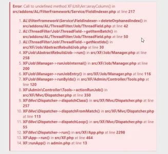

XF 2.2 ACP->Tools->Rebuild caches
[Rebuild Thread Fields]
I don't even have any custom thread fields added.
Less:
Error: Call to undefined method XF\Util\Arr::arrayColumn() in src/addons/AL/FilterFramework/Service/FieldIndexer.php at line 217
AL\FilterFramework\Service\FieldIndexer->deleteOrphanedIndex() in src/addons/AL/ThreadFilter/Job/ThreadField.php at line 42
AL\ThreadFilter\Job\ThreadField->getItemBatch() in src/addons/AL/ThreadFilter/Job/ThreadField.php at line 50
AL\ThreadFilter\Job\ThreadField->getNextIds() in src/XF/Job/AbstractRebuildJob.php at line 30
XF\Job\AbstractRebuildJob->run() in src/XF/Job/Manager.php at line 258
XF\Job\Manager->runJobInternal() in src/XF/Job/Manager.php at line 200
XF\Job\Manager->runJobEntry() in src/XF/Job/Manager.php at line 116
XF\Job\Manager->runByIds() in src/XF/Admin/Controller/Tools.php at line 120
XF\Admin\Controller\Tools->actionRunJob() in src/XF/Mvc/Dispatcher.php at line 350
XF\Mvc\Dispatcher->dispatchClass() in src/XF/Mvc/Dispatcher.php at line 257
XF\Mvc\Dispatcher->dispatchFromMatch() in src/XF/Mvc/Dispatcher.php at line 113
XF\Mvc\Dispatcher->dispatchLoop() in src/XF/Mvc/Dispatcher.php at line 55
XF\Mvc\Dispatcher->run() in src/XF/App.php at line 2298
XF\App->run() in src/XF.php at line 464

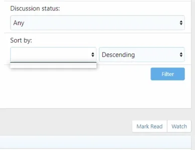

Having an issue with XF 2.2.2 and Thread Filter 3.4.4. When set to 'Above thread list' the Sort by list is empty.
It works properly with the popup, sidebar, and mobile off-canvas filters.
