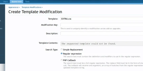

Adam Howard
AdminCP > Appearance > Template Modifications > Create Template Modifications > Template:
Type in Extra.css
Before you even finish typing it, it will show up as an option to impute.
But you will get this notice with either selecting it.
Template Contents:
The requested template could not be found.
And thus it will not let you save anything. The TMS (Template Modification System) should work with any template.
This occurs when the template HTML is empty, not just EXTRA.css. Should be easy enough to change the JavaScript that handles the response.

Template html ? I see no such template.
Or do you mean to say when extra.css is empty, because if so, mine is filled with stuff.

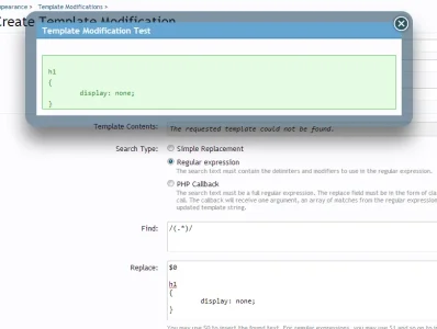

It's still possible but it requires a regular expression because otherwise it's not possible to find a simple string:
That works.
That works.

If you have 8 or more styles & you always add the same code to extra.css
Having the TMS do it for you, so you do not have to update every style individually is good thing.
Probably still worth modifying the several CSS templates via the TM system rather than using EXTRA.css.
But certainly with my solution above you can do it to EXTRA.css so that's there if you need it.
@Chris Deeming is pointing out that it's just a bug that it says that. It doesn't prevent you from saving or using a modification to that template.
The following error occurred:
Please enter a valid regular expression.
^ I also get this error when using $1 which XenForo claims is a valid expression
" You may use $0 to insert the found text. For regular expressions, you may use $1 and so on to insert sub-matches. You may use XenForo template syntax. "
I understood exactly what you were trying to achieve, so I gave you the exact solution for that. It works.
