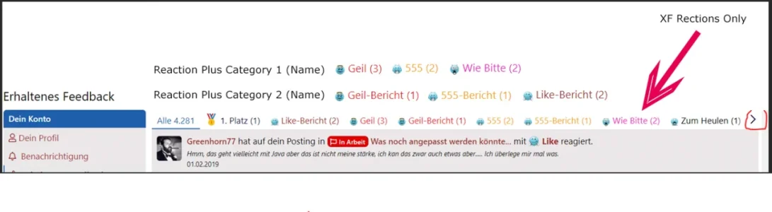

Is there a way to view the Reaction Plus Reactions by category as shown in the image?
I know this may be a special wish.
I've been trying to do this for a few hours now and can't find a solution.
If you don't want to embed this, maybe you can help me?

That's not something that will be easily doable with a template edit as we don't actually touch this page at all and the category data isn't exposed here, unfortunately
