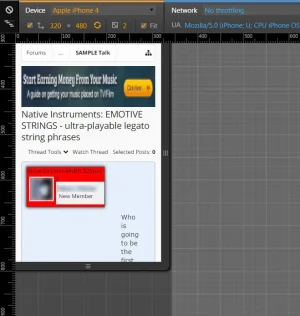

What could be the problem here?
1- we can read the @media code above the avatar
2- the text is in one column and not justified
You likely put the media query inside a regular template (and outside of a style tag), and not a css template

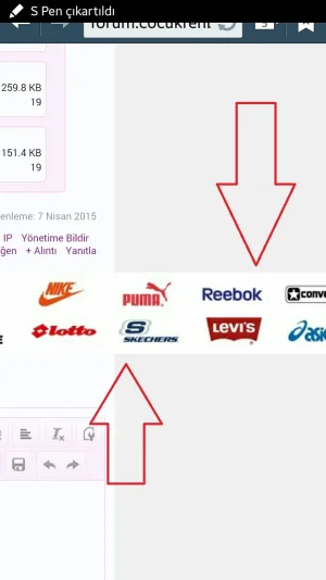

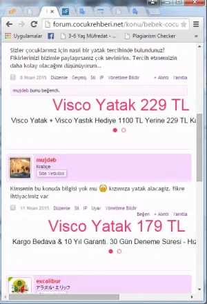

How to add Adsense ads. I add one 728x90. Need to resize automatically to mobile users. Or are adding ad 2 units. supposed to be the conversion between the two. I'm in the wrong place but I did not know. Can you help?
  • 2015-04-27 21_39_00-cocukrehberinet - cocukreh@ftp.cocukrehberi.net - FileZilla.webp
Having ad sense ads resize is against their tos. I know @Brogan posted a resource on responsive ad sense ads. Take a look at that
