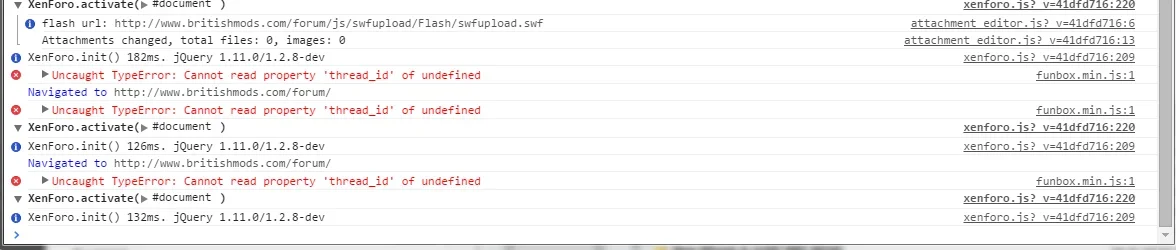

For the AdSense issue, I'm getting this console error:
Uncaught Error: adsbygoogle.push(): All ins elements in the DOM with class=adsbygoogle already have ads in them.
Which (to my knowledge) has nothing to do with the ad manager, seems like something is set up wrong somewhere.
Mine was working perfectly on the previous version, and only broke when updating to 1.0.12

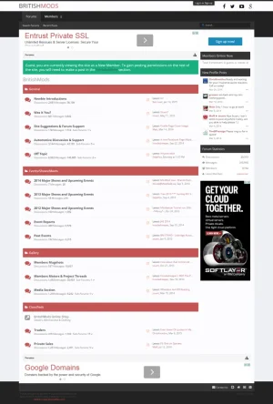

Matt,
I just went to britishmods.com and I'm able to see a few adsense advertisements
This is what I see:
-Jake
Thanks Jake, I've just checked and I can also see them now. Not sure what is happening, as I tried in 3 different browsers (IE11, Chrome and Firefox, and on multiple PCs), and none of them were working earlier.
That's odd, must've been some sort of weird caching
