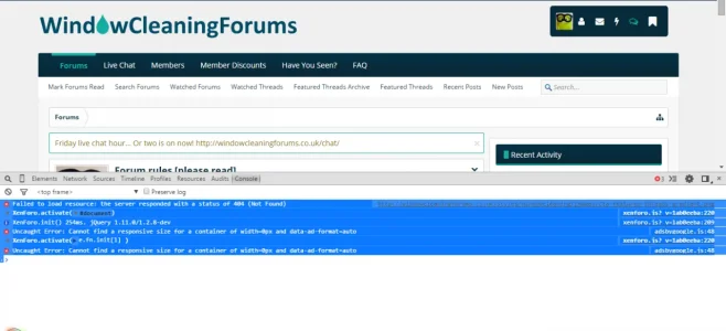

I have just done this video to try and show what i am on about @Jake B.
Would you mind opening your javascript console to see if any errors show up when advertisements disappear?

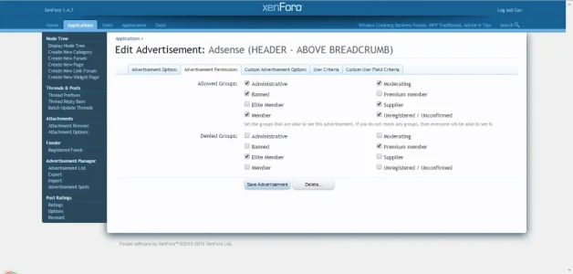

I am having a real issue with permissions as well. What i want to achieve is adsense is shown to all members except premium ad elite.
Sponsor (static) ads show to all members.
My issue is no matter what i set premium members either see adsense or all members dont see adsense.

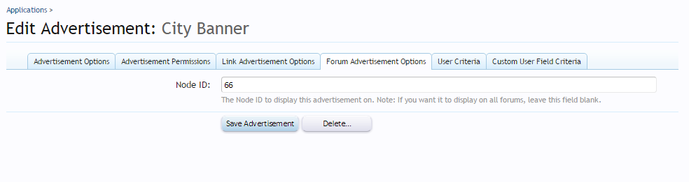

This seems like it should work, @Jake B. will take a look.Iam entering Node ID , to show banner in specific nod e, but its still shows on all nodes , what i do wrong
Yes you can add the hook in via templates and thus you can use template conditionals.is there a way to create new Spot , and make hook: as specific node/forum ?
