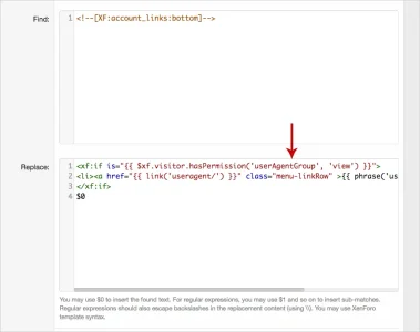

Appears when I try to use "userAgent" as opposed to "userAgentGroup" the hasPermission is never matched in the Template modification.
This works, but I would rather use "userAgent" if possible.
Yes I'm changing the Permission group accordingly.

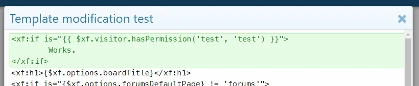

I've then created a simple template modification in a similar way:

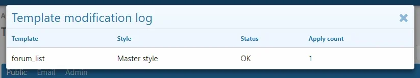

Which saves correctly:
And displays correctly:
So, something else is going on here. We'd need more detailed reproduction steps to be able to go any further,
