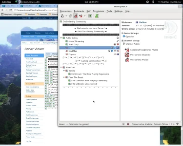

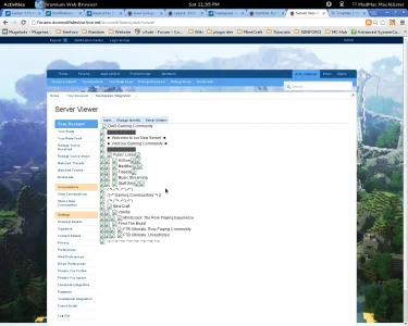

How would I fixed this issue:
Screenshot from 2013-08-24 23:35:16.webp
and make it how it is on teamspeak server (The images)
Screenshot from 2013-08-24 23:35:28.webp
First, I had to disable downloading custom icons (my server downloads around 200 ones and the flipping script times out. Nothing I set fixes it), but that wouldn't be causing this issue D:
I went to your site, (viewer isn't permission'd off, fixing in next version) and the image links are the same as on my site, but on my site they work D:
I think since you are using nginx, you might have set /library/ to internal only? That's the only thing I can think of to be honest :C or some wacky rewrite you have in place lol
I tried to navigate to the images but was unable (got a 404) so I'm not sure what to do :(
Hmm it could be an issue with permissions. Teamspeak Server is run by a different user/usergroup. I do not handle that part of DwD as a friend of mine does. So later I shall give him a shout and see if he comes up with anything. I will keep you updated. :)

Hi, I'm the guy who deals with this stuff on DwD. The problem was that infact the while "library" folder was internal in nginx. So i had to assign an empty block for the images. This is a segment from the nginx config for anyone who also has this issue.
location ~ (library/Teamspeak/API/Images/) {
    # Do Nothing
location ~ ^/(internal_data|library)\/(.*)/ {
    internal;
                # Do Nothing
        location ~ ^/(internal_data|library)/ {
            internal;
That's extremely strange, since on my setup I'm just setting internal_data and library to internal and it works just dandy. I may move the images to the styles folder in order to prevent this in the future.
perhaps yours are chmodded to 777 or something similar? that could affect it.
scratch that, i know why. Before we had
So it was everything in internal_data or library, not just those root folders. Which infact i must correct in that file. Which then protects everything in the folder, including all subfolders, except for the images. I'll update my previous post with the correct syntax.
