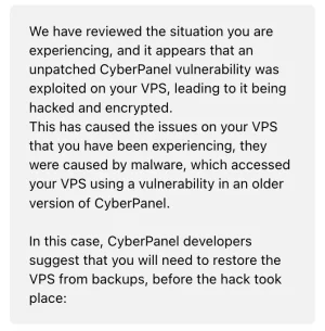

CyberPanel can go **** itself -.-
Ouch @DragonByte Tech that your server or just sharing someone's screenshot ?
My server. I got the notification from my web host that my CyberPanel version was vulnerable 2 hours after the attack had taken place.
Since CyberPanel doesn't have a working auto-update feature and running the upgrade script often requires a reboot of the server because its upgrade process is so poorly written that the server is left in a non-functional state after running it, I had no real way of knowing this was even a thing.
Given the RCE writeup can see why CyberPanel would be a frequent target for 0 day exploits :(
Hopefully you have a usable backup to restore data from.

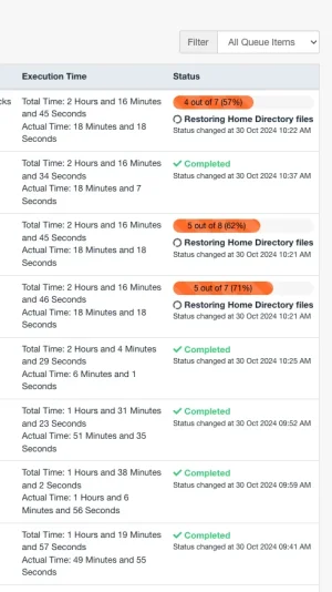

Yeah, although it is six days old. I paid for CyberPanel's advanced pack - or whatever it's called - to enable daily backups to S3 like I had with cPanel, but the instructions provided didn't work as the instructions were for an older version of CyberPanel and they couldn't provide up-to-date instructions. I have to rely on the host's backups.
Needless to say, I deeply regret my decision to use this absolute dumpster fire of a control panel. I'll likely bite the bullet and go back to cPanel, this sort of garbage where you have to run a shell command and reboot the server to do something as simple as applying security updates is exactly what I wanted to avoid when using a control panel software.
cPanel / DirectAdmin if my customers want a control panel.
While expensive, nothing comes quite as close to cPanel in terms of ease of use and maturity. Yes, I get absolutely shafted on their pricing, but everything "just works" and they fix things when it's broken. Can count on one hand the number of tickets I've had with them over the last 10+ years of using it.
Even testing the backup and restore process with Jetbackup integration in a DR scenario:
