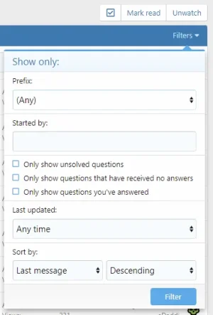

In that case, you can implement something similar to how threads are filtered in a forum.
Check through the code to see how that's achieved.

So as suggested I was going to look at how threads are filtered in a forum, check the code and try and work something out but I'm not sure where to start, any further suggestions or pointers would be appreciated. Thanks
