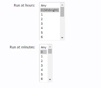

Make sure that 02:00am in your cron tasks are correct. The cron tasks are server time, but if you look at the list of cron tasks, it'll give you the actual time it will run, based on your locale. So you might set the time for the backup to run at 0200 in your cron, the actual time may very.
For instance, my daily database backup is set to run at "midnight", server time.
But if I look at the list of cron tasks, it tells me when it will be, local to me, 6:00pm
If you turn on the debug option on the miscellaneous tab, it will produce a debug log file when the backup runs. Try that, and then send me the output in a conversation here, and I'll take a look to see if there's a problem with it.
It just worked. I think the time must be off like you mentioned above.
