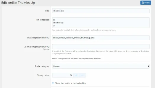

I've got a bunch of old smilies we used in XF1.5, that were brought over to XF2.1. They appear fine in the admin panel and should be visible in the WYSIWYG editor, but they don't appear. Using the smilie bbcode manually in the editor works.
Here are the settings:
192989

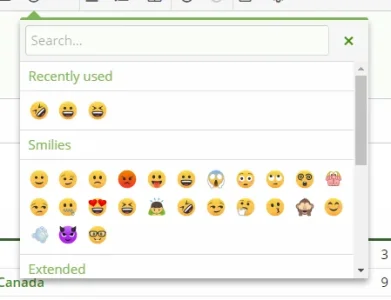

It doesn't appear under recent, smilies or the extended category (yes, I have scrolled down ;)):
192988
I've resaved some the smilie entries and changed categories, but they still don't appear in the editor.

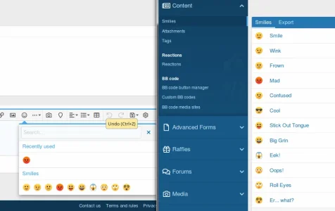

There are 24 smilies showing up in the WYSIWYG editor, but 31 in the admin panel that should all be showing in the editor.
Yep, it's checked for them all (see attachment in 1st post). If you try a fresh XF2.1RC1 install (with emojis disabled), you may be able to replicate it - I tried just now using XAMPP on Windows 10 and could get the same thing to happen.
I can confirm the same problem in RC1. There are 12 default smilies in the admin, but only 10 show...

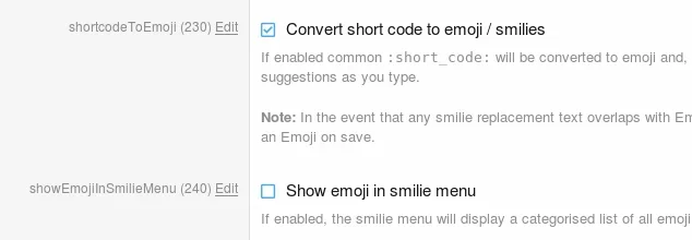

I think we have a fix incoming for this. The issue is that certain smilie shortcodes are overlapping with emoji shortcodes and the emoji ones are missing. In addition, we might not have been taking into consideration here whether you have the shortcodeToEmoji option switched off.
My bad it's the second option that we're not taking into account here.
But even if that were enabled, all you'd find is that in the list you would have the 👍 emoji but still not the (y) smilie.
