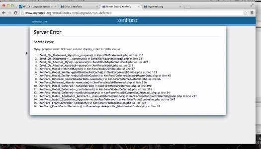

Untitled.webp I just tried to upgrade again and still get the same error with everything disabled :(
I have no clue how to fix this.

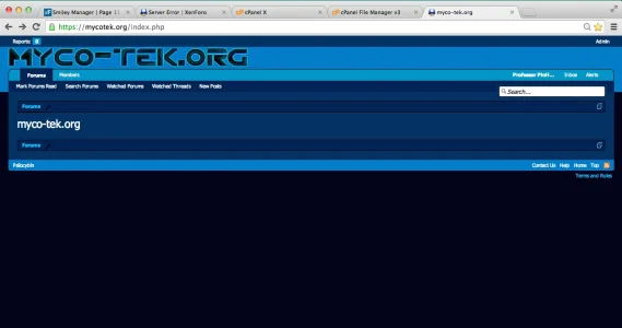

When I upgrade to 1.3 this is what the boards look like.
Well I finally got it. I hadn't deleted the spritecow files and that seems to be what was hanging me up. Becuase of the spritecow files it wasn't letting me run the queries required.
After running the quires post file removal I reran the upgrade and it finally finished and let me back into the admincp.
