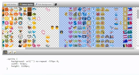

I'm trying to add this sprite sheet (32x32), but can't seem to single out the emoticons. It selects a large chunk of them whenever I click on any single emoticon.
It does however work great with this version of the same sprite sheet (64x64).
Any ideas on why this is?
