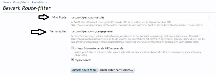

does this has something to do with route options because the normal routes are in English and i translated them into Dutch
i.e. see visual below

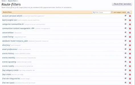

got 35 routefilters...how do i list them since i cannot select the text
Screenshot, or, alternatively, if you're comfortable running queries on the database, run this query and copy and paste (or screenshot) the output:
SELECT * FROM xf_route_filter WHERE enabled = 1
