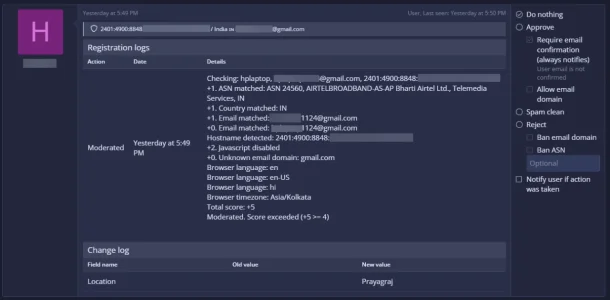

Some question regarding the Addon:
1. Why I get two "Email matched" entiresi one with +1 and the other with +0 although it is the same Email
And why get the entry:
+0. Unknown email domain: gmail.com
although in the addon setting, under Email rules I got the Rule:
+0|*@gmail.com
2. What security disadvantage does it have for me if someone says "Javascript disabled":
+2. Javascript disabled
I don't quite understand this part either:
Approve
Require email confirmation (always notifies)
User email is not confirmed
Will be sent another email to the user to confirm his email and only if he confirms his email, the account will get autmatically approved ?
Could you please explain this area in more detail how the process works here?
+0|*@gmail.com
You have to add the domain to this section ..admin.php?banning/allowed-email-domains
That section you are referring to is just for scoring email domains, that doesn't put them on the 'allowed/known' list.
This is used to identify potential bots and other malicious tools. It's a part of the scoring process, so you can configure it how you see fit.
Do you have Google auth integration turned on? If you click "Approve" with the "Require email confirmation (always notifies)" box checked, it will send a email confirmation message. If they came through the Google authentication, they won't get a email confirmation message the first time.

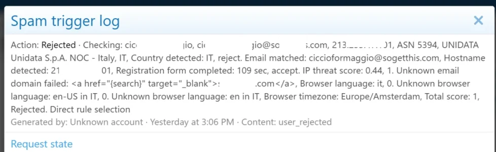

I don't know how you're getting 2 emails in that checking process, I've never seen that happen. So, @Xon would have to answer that one.
You've got an email rule matching the email address, sadly doesn't really report wildcard matches well.
Because the add-on doesn't ship with a list of "known" or "approved" email domains. This functionality is designed for sites which have a list of email domains which are known allowed/good. That is it supports grey-listing unknown email addresses.
+0|*@gmail.com
This is where the +0. Email matched: xxxxxxxx1124@gmail.com is coming from.
Having javascript disabled during signup is fairly unusual these days. It used to suggest bot-like behavior.
If a user appears in the approval queue, they have not been sent a confirmation email. Setting them to approved bypassed email confirmation, this is a poorly documented design flaw. There is a reason it adds the "user email is not confirmed" sub-text.

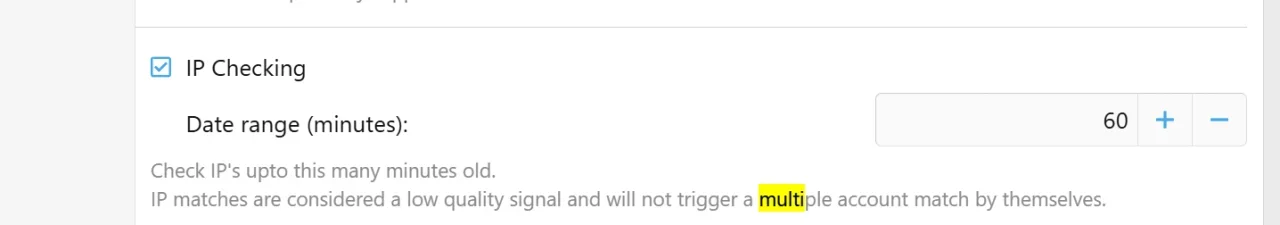

How to avoid multiple account detection based on IP?.
Since most users are connected via VPN, proxies, or CGNAT, they often have identical IP addresses.
Therefore, I want to avoid these being recognized as multiple accounts based JUST on the IP adresses.
I would like the recognition by combining IP + Cookie + and if possibly by a third additional feature
Is this possible, and if yes, how ?
  • Like
Reactions: USY
The current version doesn't trigger multiple account detection purely of shared IP usage, it requires the cookie hit (or email link usage hit) and then logs if a shared IP was also detected

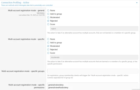

I don't understand the difference between:
Multi-account registration mode - general
and
Multi-account registration mode - specific
Can someone explain this ?
If a multi-account is detected, and it is banned or a member of a specific set of groups or has a specific permission then do one action (probably this one should be reject). Otherwise do the other action (probably should be moderate)
  • Like
Reactions: USY
If a multi-account is detected, and it is banned or a member of a specific set of groups or has a speisifc permission then do one action (probably this one should be reject). Otherwise do the other action (probably should be moderate)
How can I prevent new registrations if a user already has an account?
Would my settings in the screenshot good?
