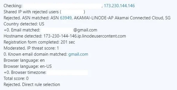

You need to show an example from the User Registration Log to show what part of their registration is being rejected.
../admin.php?logs/user-registration/
Example: (We're looking for lines with 'rejected')
In this example above, this user was rejected because of the source network (ASN).
There's also a moderation flag fo IP thread score, but this would not trigger a direct rejection in this example.
If you can show us an example, we can help ID the reason for rejections.
My immediate guess is the IP scoring, since that's a common one.

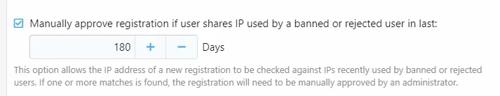

What do you have set for this one? ../admin.php?options/groups/spam/#approveSharedBannedRejectedIp
Thanks for that, l was looking for this option in the Signup abuse... Add-on, not the default options! l've set to 7 days already, may reduce further.
