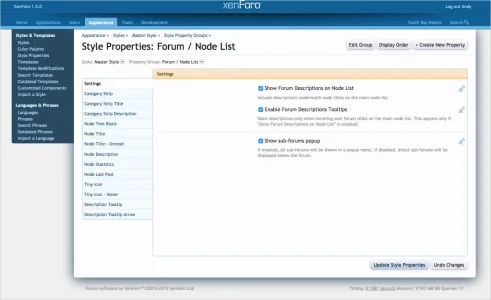

Uncheck the "Show sub-forums popup" box.
Thanks Andy. That's not what I was looking for but that is something I can use for another purpose.
