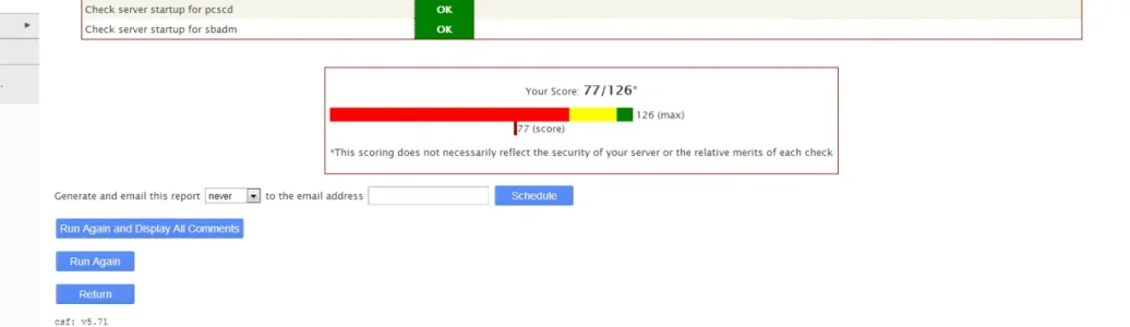

OK, so just to clarify a few things with the server. All server software is upto date, now running php 5.3.19 and mysql 5.5.27-cll. Apache is running in suphp mode, so each domain is segregated from each other. There are no successful authentications via SSH, although it's constantly being brute forced.
root@blu [/var/log]# less secure | grep "authentication failure" | wc -l
6668
The only FTP access I can see is Jake the other night.
iptables is running, but it's only set up for godaddy. I'd personally like to install config server firewall, which integrates nicely with cpanel, but I don't know how this would react with the existing iptable rules??
I've ran both rkhunter and chkrootkit, and neither of those have found anything.
WHM is on the latest version.
One thing I have seen, is that ALL users on the server have full shell access. I'm also not seeing SSH logging accepted attempts, eg on one of my VPS
