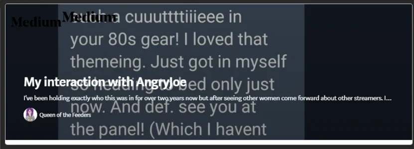

This medium embed is borderline unreadable, any hints on how to hit it with a css styling stick? Or this just on Medium ****ing with their layout again;
https://medium.com/@WookieMonsterTV/my-interaction-with-angryjoe-d715aedb0e02
I'm not sure what it should really look like, but that isn't it.
he did say that medium seems to have given up on their embed code on previous page.
