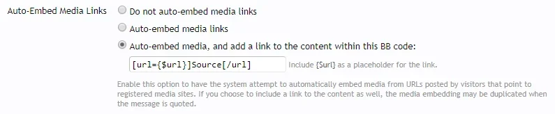

XenForo doesn't keep the original links unless you've configured it to add a link below the embeds.
This is possible in the options? Or how would one achieve to have an additional link below the embeds, please? Or did I get this totally wrong?
