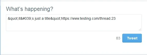

is it just me having issues with the twitter share?
it seems that when you share a title with "" in the title, its kinda messed up.
maybe it's an issue with twitter?
in this screenshot, the thread title i am wanting to share says "it's just a title" but looks like this:
also, wondering about, why the URL has no spaces between the title and link.
again, could be just twitter issue?
thanks.

Confirmed, quotation marks and apostrophes in the title are the cause. When I get some free time I will take a look and update. Thanks for the heads up. :)
SimonV updated Responsive Social Sharing Buttons with a new update entry:
Responsive Social Sharing Buttons 1.5.1
A quick update to fix the missing titles and issues with quotation marks and apostrophes in shares.

The update I just added should fix the issue with quotation marks and apostrophes in the title, let me know if its ok now.
Thanks.

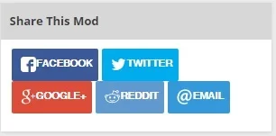

@SimonV first of all I'd like to thank you for your awesome work. These buttons are so much better than the default slow loading sharing tools. Kudos for providing this free service to the community.
I have installed the latest version of the mod and my sidebar block is looking wrong. Is there some setting I've missed?
Looks like the js file is missing.
Try in a clean unedited XF style and see if the issue is still there.
I just noticed the cause 0f this, it only happens when no Twitter Username is set in the options, will fix in the next release.
Fixed it, thanks for the lead (y) Reverted the "page_container_js_body" template and all looks fine now.
