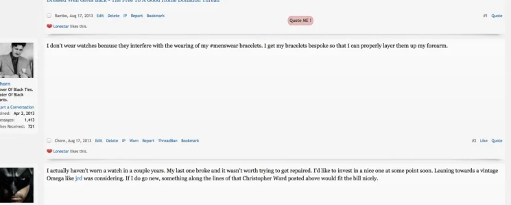

I think I did find a bug though: When selecting text and the Quote Me button pops up, then you unselect said text, sometimes the Quote Me button is staying on the screen:
In this example I scrolled up after unselecting the text.
It's because I needed to check the parent container for the touch version. You need to click on the post message zone to make it disappear at the moment. It has been fixed on my local installation. I've also added a few things (safe) to this version. I will release it today or tomorrow.

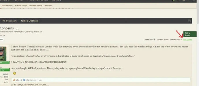

I'm testing this add on out, and do not understand how to have the feature on activated all the tie. As it stands, In order to use the feature, I have to click the link each time I enter a forum . . .
@cclaerhout yes that did it. I had read the description of that toggle severa; times but just wasn't thinking that's what it meant. I should just flipped the switch to find oout but I have screwed my forum up enough times that I don't like flipping switches unless I'm pretty sure I know what it does. Thanks!
