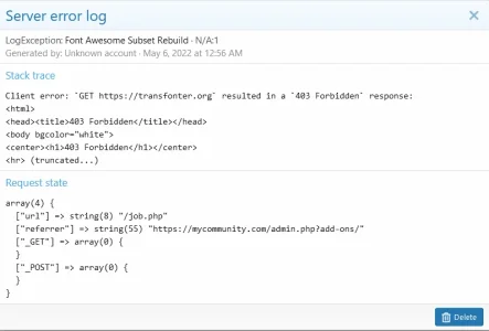

Just logged in to the ACP and noticed these errors were reported:
1651843981865.webp​
The above notice is still there...
@Kirby could you please advise how to clear this out?

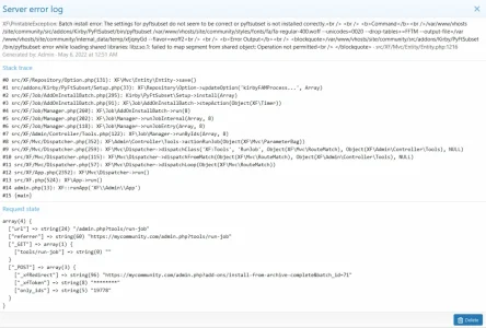

I get this error on install

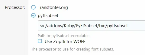

I've now installed it on a test clone, I get the exact same errors but I dind't actually understand what's the pyftsubset path I have to put in the field...
I thought it could be the addon's /bin folder, so I tried this
But this is the result :cautious:
1651854095793.webp​

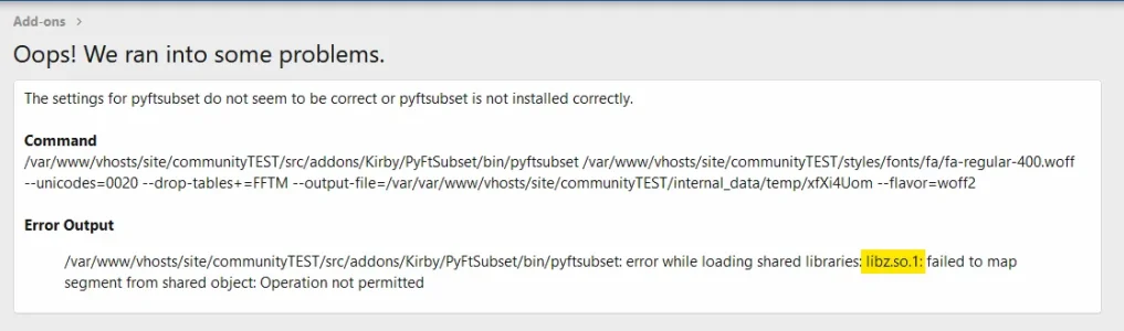

I assume there's anything I can do about this libz.so.1 libraries... 😞

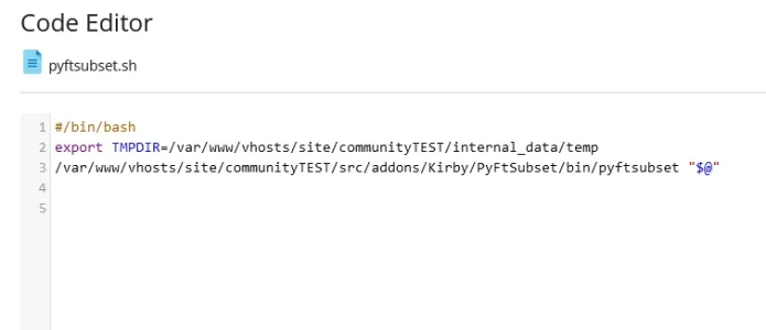

Try to create a text file named pyftsubset.sh with the following content
Bash:
#/bin/bash
export TMPDIR=/var/www/vhosts/site/communityTEST/internal_data/temp
/var/www/vhosts/site/communityTEST/src/addons/Kirby/PyFtSubset/bin/pyftsubset "$@"

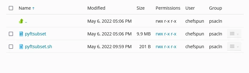

, upload it to directory /var/www/vhosts/site/communityTEST/src/addons/Kirby/PyFtSubset/bin in text mode, chmod it executable and change the option to use this wrapper script.
Thank you so much buddy,
I could finally save the FAM settings, so I tried again installing the pending PyFtSubset add-on but I still get this bloody libz.so.1 error 😑
