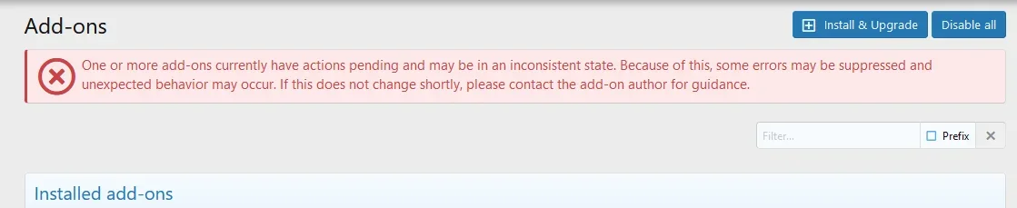

I got an error while installing this one, so I uninstalled it and I now see this notice:
How can I get rid of it?
